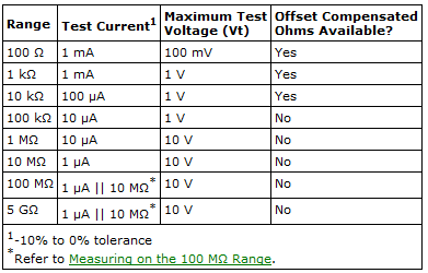

Thanks for the additional information on the measurement.  In the future, you may want to consider posting to the DMM forums as you will likely get a quicker response.  In circuit measurements can be a little tricky sometimes, especially when using auto-ranging.  The 407x DMMs has a 10 k and 100 k resistance range, so when you pick 20,000 it get's coerced up to 100k.  Have you tried using the 10 k range?
What makes the measurement tricky when using auto-ranging is that anytime the DMM changes resistance range, it can change the test current applied to the DUT.  When charging a parallel RC circuit, the DMM starts off seeing a very low resistance because of the discharged cap, but once it starts charging, the resistance "seen" by the DMM increases and the DMM range-changes to a higher range. When this happens the test current becomes smaller and the cap begins to discharge through the parallel resistor.  The DMM then begins to "see" a lower resistance and range changes back to a lower range.  Sometimes this cycle goes on indefinitely and other times the DMM will settle to a final range; it's really dependent on the DUT.
Have you tried taking a resistance measurement in Soft Front Panels in the 10 k range?  Do you still see 8k after letting the measurement settle out?  Are you expecting to see 10k or are there other parasitics in your circuit that could be skewing your measurement?  Let us know what you find when you get a chance.
For reference, below is a table of the test currents used for each resistance range of the 4070 DMM.
