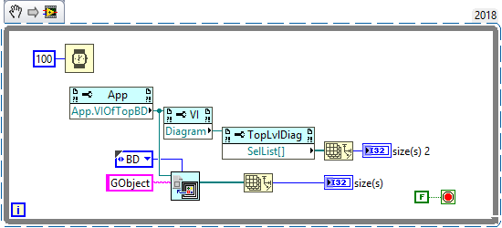

If you start this code running in parallel with development, you can poll to see how many objects exist on the block diagram of whatever the top-most VI is and how many objects are selected.  By checking each successive polling for changes and then logging those exact changes, you can get a pretty good idea of what is being done on the block diagram.
Adding code to parse the arrays of references to actually check what has changed (and to ensure that when the developer switches which diagram they are editing it doesn't log 1000 changes all at once) is left as an exercise for the reader.
