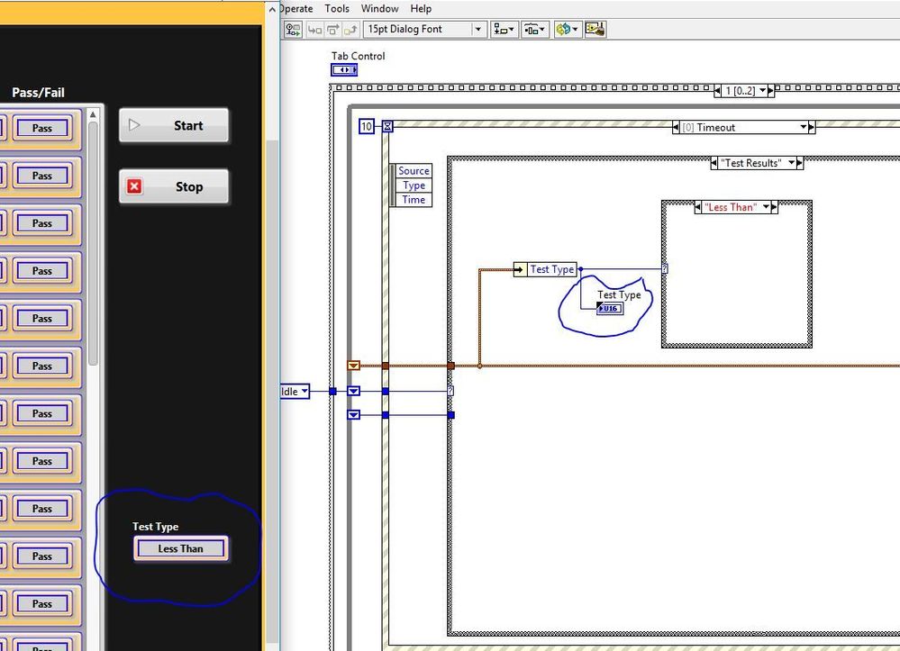

Anyone know of some secret properties thing or something that I'm supposed to do to get this case structure to update off of this enum?  I know it's a little on the odd side since it comes from a cluster, but I thought that was still supposed to work.  I scoured the known issues and didn't see anything (not immediately anyways) that pertained to this.  So.... any help here would be hot.

What do you mean by "update off of"? Are you renaming an item that has a corresponding case?

I mean when you type in "Less Than" (a name clearly visible in the Enum), the Case Structure does not recognize that.  It only recognizes actual numbers (which I understand an Enum to be).  The Case Structure is not showing the actions items from the enum.

Wait... so apparently that's not actually an Enum..... okay, problem solved.  (Shakes head and face palms)  I didn't know you could set values for a U16 and it not be considered an Enum.  Learn something every day.
