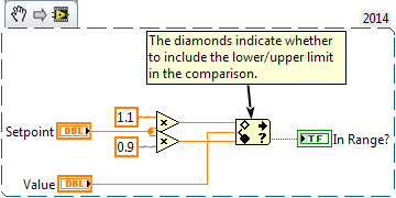

You want to look at In Range and Coerce.
(4,744 Views)
Accepted by topic author russell.simms
Try this:
(blog)

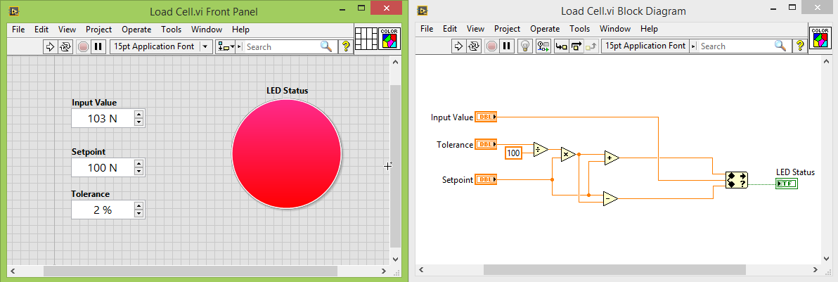

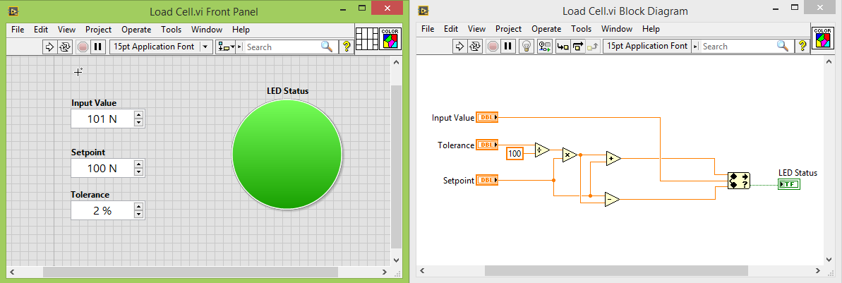

you can use the the range check function as suggested by Raven fans and sam_sharp suggested.
Have a look at the attched vi.

I figured there was a simple solution, but did not know of this function before and it worked. Thank you everyone!
