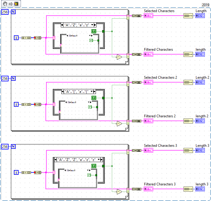

Case structure with range of string characters ("A".."Z") doesn't include last character in the range
Is this a bug?
Intention: filter the string character based on whether or not its an 'alphabet' character.
Approach 1 (Loop 1): Using case structure with string characters as range ("A".."Z", "a".."z")
Issue: last characters in the specified range ("A".."Z", "a".."z"), which is "Z" and "z" are not included.
Solution 1 (Loop 2): Include next character in series so that required character is no longer the last character. Instead of "A".."Z" make is "A".."[" and instead of "a".."z" make it "a".."{"
Solution 2 (Loop 3): Include the last character ("Z" or "z") again.
The default case (in all case structures) contains a FALSE constant.
Lower two loops give me intended result (filter all characters other than alphabets).

No, that's the correct behavior for strings. The Help file for case structures links to this:
https://zone.ni.com/reference/en-XX/help/371361R-01/lvhowto/case_selector_values/
Numeric ranges are inclusive, but string ranges are not.

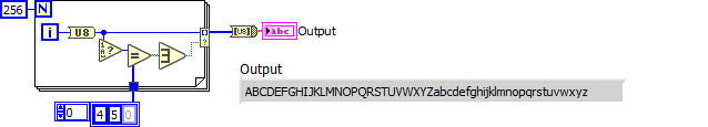

A good tool here is lexical class. (Make a case for 4&5)
Some examples:
