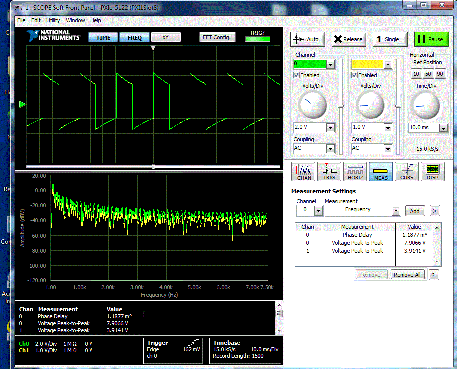

Hello Lynn,
below are the screen shots of the waves. This is the wave when its out of sync.
This is the wave when its in sync.

I am not familiar with the scope module.
I notice that you are looking at AC coupled signals.  It is not clear from the image whether the trigger signal is also AC coupled. If the signal is a zero-based square wave and the trigger works on the original (not AC coupled) signal, the 162 mV trigger threshold may be close to the actual level of the signal. Try increasing the trigger to ~ 500-1000 mV.

Hello Lynn,
The signal is DC coupled, and the waves themselves are bipolar. I can trigger off the waves fine, my problem is that I'm trying to monitor the signal and see if the signal falls out of sync. I have a set period of time where the signal needs to lose sync but the time within that period is always different. So I litterally have to catch the second wave when the phase changes.
