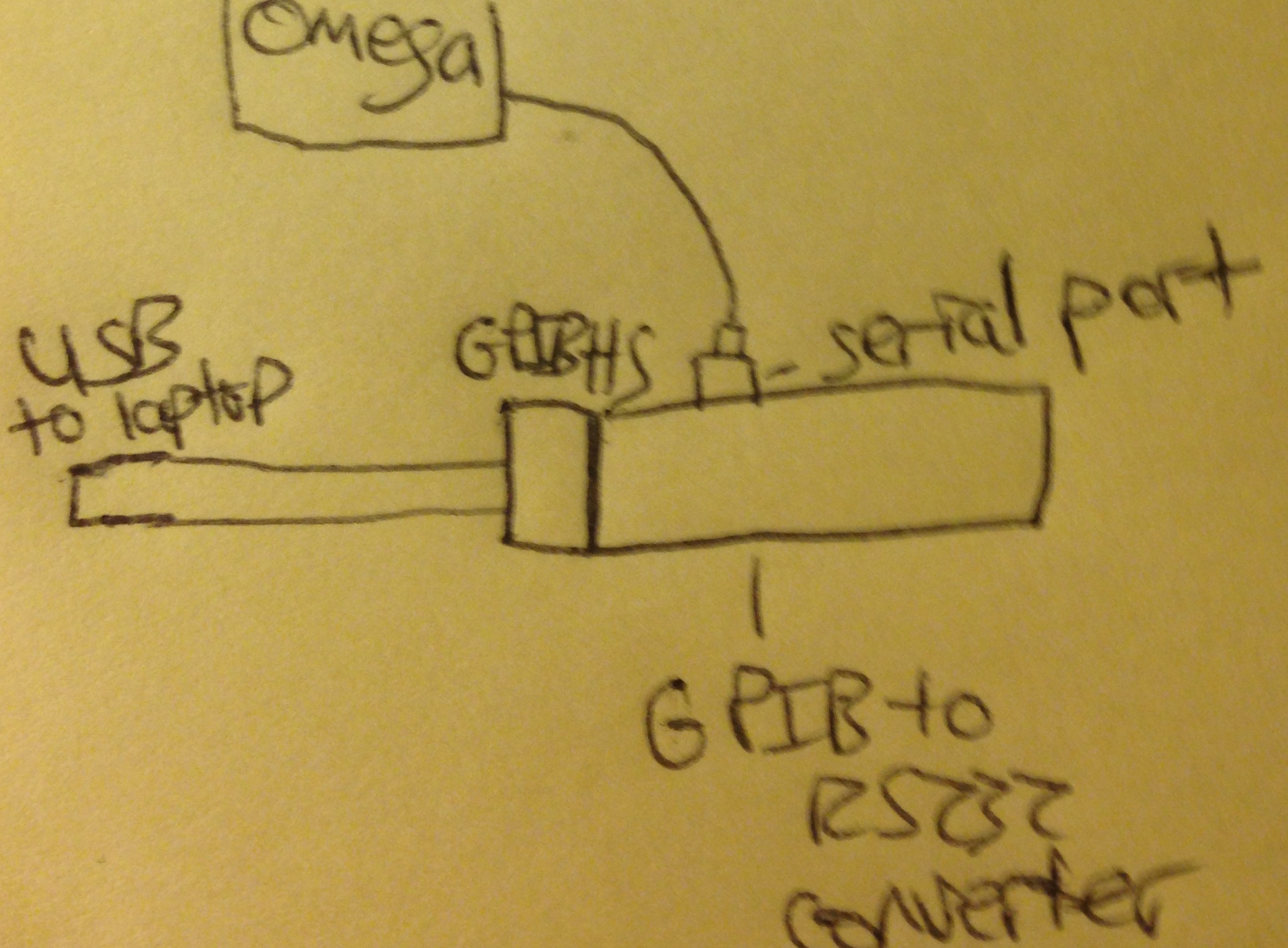

For the project we're working on, my boss wants everything on GPIB. So while it does seem simpler to use a USB to serial cable, he doesn't want that option. For that reason, I'm pretty sure that the serial board option was not used. Instead, the RS232 board was installed so it could connect to the converter. This is a somewhat crude drawing of the setup but it's the best I can do until I go back to the lab Monday.

I would question the boss but that's a moot point.
You have not mentioned the GPIB-Serial device. Is it the one from NI? How did you configure the switches? What command from the instrument manual are you sending? Where is the manual? As I mentioned, IDN is worthless to send and you did not attach a manual that does explain the programming.
