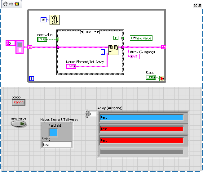

I see, as far as I know, that's the expected conduct of the table control.
You could use an 1d array of clusters, each cluster containing a color-box and a string ...
