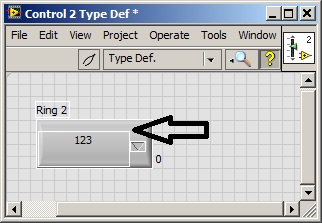

Pretty old thread this but you can try creating a type def from your menu ring and then
edit it by dragging down the top of the text box as shown. Smiley Wink

Nice example Neil!
This is an old thread, but the same issue.  I don't use ring menu's too oftem, but normally I can get by with font sizes.  If you have 1 line of text instead of 3, just add a CR.  But if you end up with 2 lines of text instead, then it looks bad.
