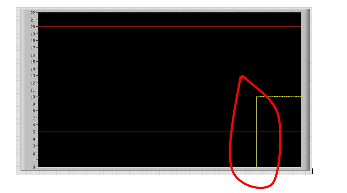

how can I change the type of interpolation of a waveform chart partly? Check attached picture.
I don't want to have the yellow interpolation at the beginning of the measurement.
I know that the interpolation can be changed with property node but this has influence on all points.
Any idea ??

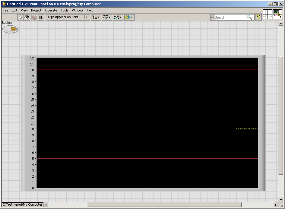

Hi maximint,
- uses NaN values to hide unwanted points in the plot
- use separate plots when you don't want those "edges" in the plot line
(2,733 Views)
MANY THANKS!!!  This works.
