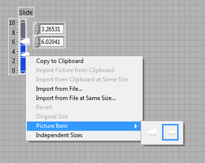

I have a question about the numeric slider.  I've right-clicked on it and brought up the Customize screen.  I can right-click on it to change the needle picture from the triangle to a rectangle, but I also see a second blue triangle in the Picture Item list (see the attached jpg).  Is there any way to change this picture item as well? I know that I can something similar with Booleans.
On a related note, what I'm trying to do is replicate the slider in the attached Slider.ctl.  The needle is gray by default, but when I click on the needle to move it, it turns blue.  Would the second picture item be the "selected" image?

Right click the control and select add slider this will add the second picture item. Then you can customize however you like.
Chris

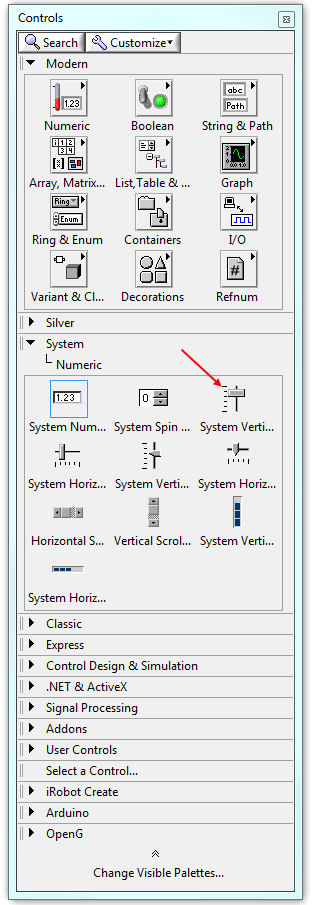

Look at your System Controls, you will find the one you are trying to duplicate.
(5,383 Views)
Zilla,
Thank you very much.  I don't know how I missed it on the Systems pallette.
