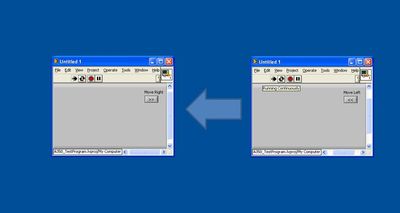

I couldn't find any post which talks/discuss about changing the VI Position at runtime, that's why I have posted this question.
I want to change the VI Position at runtime, but when I change the VI position at runtime, its not reflecting on the VI. When I run it again( I mean 2nd time) , VIs position got changed...
Is it possible to change / move VI position at runtime without stop the application ?
Thanks for your help!

You have to play with the Front Panel Windows Bounds.  It can get kind of tricky, so be careful.
