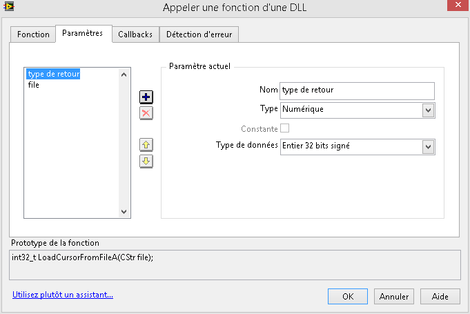

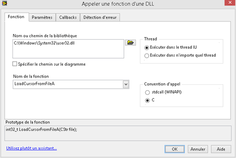

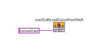

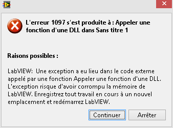

I would like to change the mouse pointer but not only on the front panel of my VI.
I tried using the user32.dll library but I always get an error ...
Do you have an idea of what's wrong?
Thank you.
Capture d'écran 2018-07-09 17.48.51.pngCapture d'écran 2018-07-09 17.49.10.png

Did you try putting in the full path to the cursor instead of just the file name?  "C:\Myfiles\cursor2.ani" or whatever, instead of just the file name?
(2,481 Views)
Hello Kyle97330,
The solution is found (thanks to ouadji), I have to choose stdcall (winapi) in the first panel and it works now.
