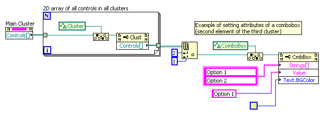

I haven't been able to follow your "best practices" line, so can't comment.   But I played around with a Cluster of clusters and I think you can do what you want with it.  Use the "Controls[]" property to aquire an array of references to your set of clusters, and "Controls[]" again to get a 2D array of references to all subcontrols.   Then you can easily index out a reference to a specific string, say, and set any property you want (you'll need to cast the control ref to a string type).  Easier than other possibilities.

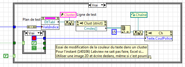

You mean, something like that ?
Tried without much luck, hence I disabled it.
This one works instead :

You need to start with a Cluster or clusters (so each contained cluster is a separate control with separate attributes), rather than an Array of clusters (where there is only one contained cluster control for all elements).   Like this:
This way has the advantage of allowing all attributes to be set, for any kind of control.
Added later: using references like this also allows one to dynamically register on the individual controls, allowing LOTS of fancy UI work.
