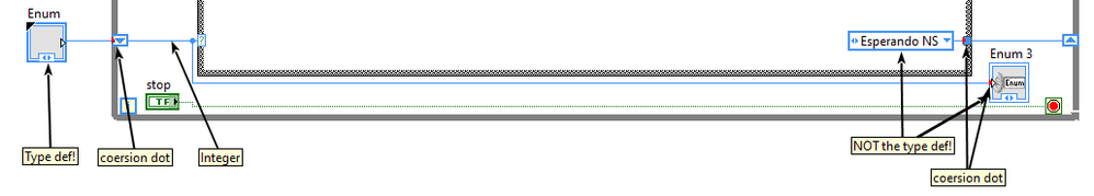

I tryed to change the name of one of my cases with the typ.def but I continue seeing the positions of the cases (0,1,2,3) instead of seeing the names.
This is my program

In the case structure, you're not using the type def you created.
In case 2 (any case actually), you wire an enum that is different (and not compatible) with the type def. So, LabVIEW converts the data type to a plain integer, because that will fit the type def and the enum.
Note the red coercion dots! That's where it goes wrong.
It seems that you programmed the cases, and then decided to make the enum a type def. Now you have to replace all the enums with the type def. That's why you make the enum a type def before you start using it! Next time...

okey!! Thank you so much!!

With the picture and the explanation I have undrestood perfectly! Thank you so much for your big interest helping me! I am so grateful!!
