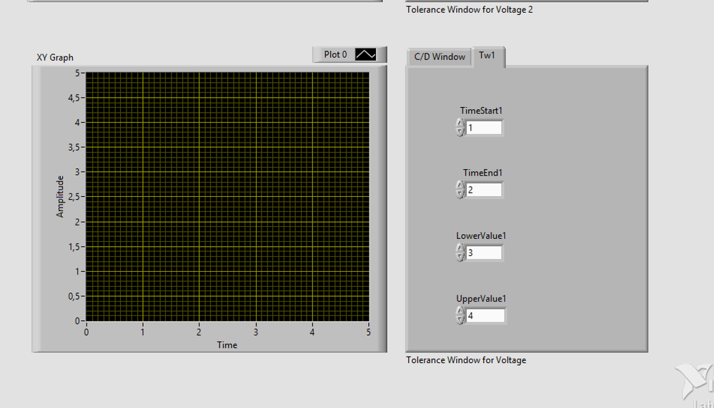

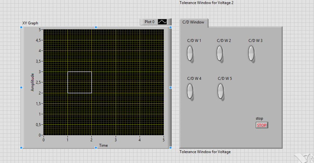

I have a problem with the program.
Since the program starts to run, I can't change the value when running.
Any ideas?
For the details, I attach the Vi and the pictures.
Thank you guys

Hi Liidle,
did you take the free beginner courses offered by NI to learn LabVIEW?
Why are there so many local variables in your main VI?
Why are all those control terminals unused in your code?
Why don't you resize the IndexArray functions to index more than one element?
Why don't you clean up your code?
Why do your subVIs only use default icons?
Why do you need an additional subVI to build an array from the outputs of the other subVI?
Since the program starts to run, I can't change the value when running. Any ideas?
Why are parts of your code outside of loops?
THINK DATAFLOW!

I put the code outside the while, that's the reason why it doesn't work.
I will look at the beginner course.
Thank you for your advice
