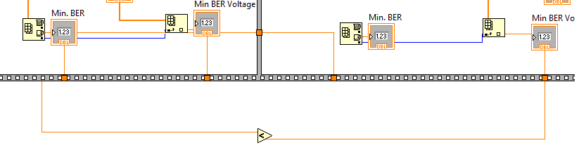

Hi all,
I have a case structure. Based on whether the case is t/f I would like to change the value of two variables. If I put the two variables in the true part of the case strcture they can't be in the false part. How would I assign them values outside of the case structure? Could I refer to them numeorus times in the different cases? Thanks.

Here's the part of the code. Basically I have 4 values. I then compare two in order to determine which values to use. Should for example the value on left be greater, I want to write the two left values to a pair of vairables. Should the value on the right be greater I wish to write the two values on the right to the pair of vairables mentioned previously. I tried writing them in a case structure but I couldn't put the variables in both the true and false part of the case structure.

Bascially I would like to say in pseudo code if the four top values are w/x and y/z and the two new values are a/b
if w > y
a = w
b = x
if y > w
a = y
b = z

So something like this?

Yes! Exactly what I was looking for. Thnaks!
