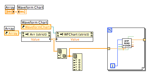

I can't see exactly what you're trying to do, but it seems to me you're making a lot of things more difficult than they need to be.
To start with, according to the detailed help:
Index Array Details
... By default, if you do not wire any index input terminals, the first sub-array indexes row 0, the second sub-array indexes row 1, and so on.
That means that you can eliminate the clutter of trying to squeeze all those indices onto the multiple copies of Index Array. (The help doesn't say so  explicitly, but I believe that you can use this shortcut with an offset as well: if you wire n to the first index terminal and leave the next three unwired, you'll get items n, n+1, n+2, and n+3. But all your array building starts with item 0, so this doesn't matter for now.)
Secondly, you seem to be doing the same thing to each element of the array and arraying the the various processed outputs. If that is the case, you can make your code much more explicit, much more compact, and much more flexible by using a self-indexed For Loop as indicated in the drawing below. (Without your VI it was too much of a challenge to fake all the connections, but you get the idea.)
Finally, if you intialize all your waveform charts with 2-D arrays, then you can wire 5-trace or 8-trace data into any of them without breaking wires, as you can easily demonstrate with my earlier example. The drawing below shows that this array approach can work just as well (with references) as the cluster approach you took and it allows for the multiple inputs you need.
