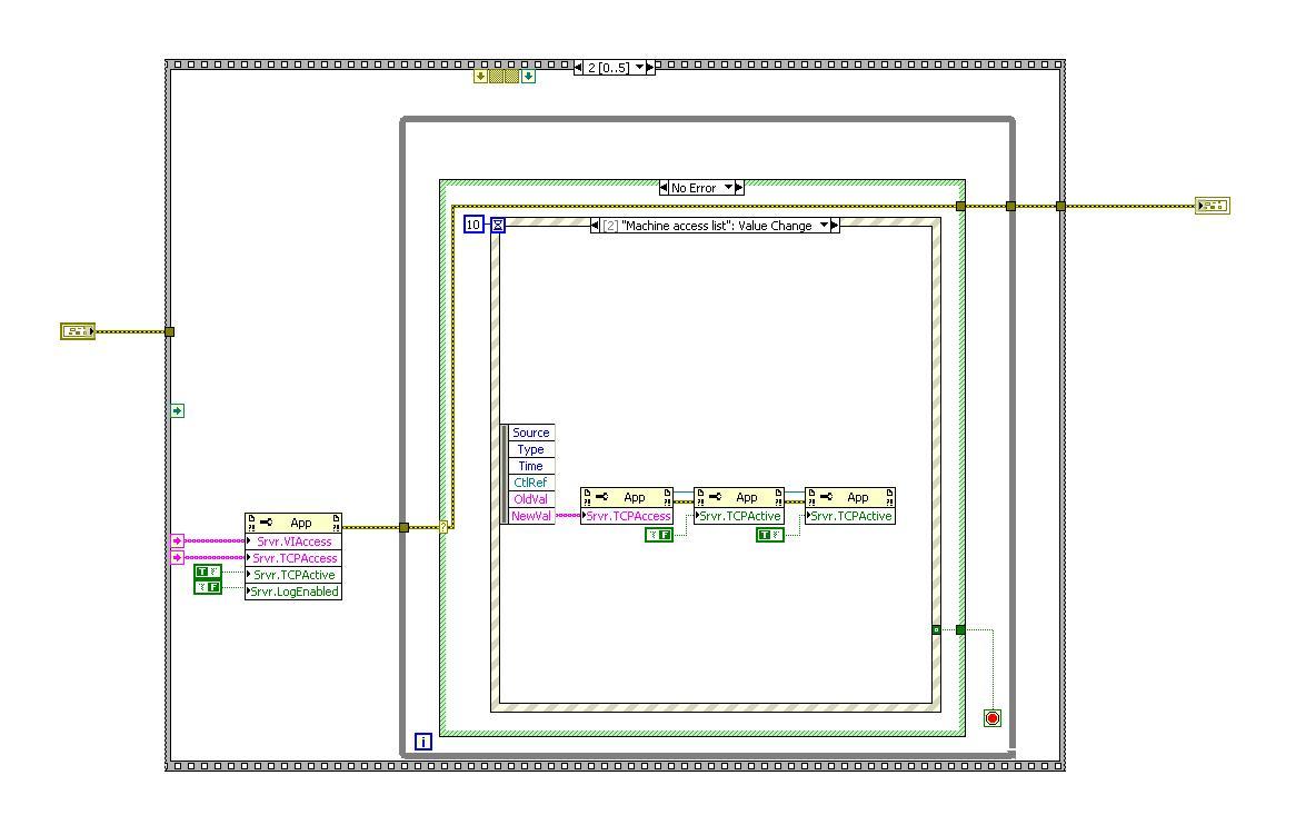

I can try to explain a bit more what I'm trying to do. I'm trying to build a VI-Server system with a main server and a backup server on different machines and even different platforms (windows and linux). I would like to change the access list when the server is running. eg if a client are making so many connections that the performance are going down, I would like to be able to "kick" that client from the server without causing problems for the other clients. I have been experimenting a bit with this and found some strange behaviour, I can add machines/adresses to the access list without problems, but i can't remove machines/adresses (put a "-" before the names) without restarting the tcp/ip-listener. This can cause that the clients get a timeout (depending on the clients refresh rate) and jump over to the backupserver (not good).
Picture showing what i have to do to change the tcp/ip-access in windows:

I´m not quit sure, but what happens if you try to remove the machine from the list using a delete from array function instead of "deny" with a minus? I tried a little bit around and thought this might fit! Please make a small test and let me know what you think!

Thanks for the help:smileyhappy:
I tried doing what you suggested, but I still can't get clients to disconnect without restarting the tcp/ip-listener. Seems that it doesent make a difference deleting them from the array or changing the + to - before the addresse. Strange...
