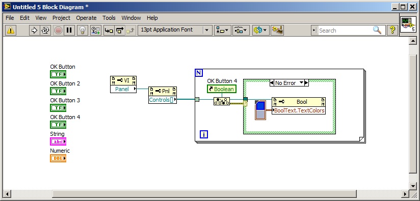

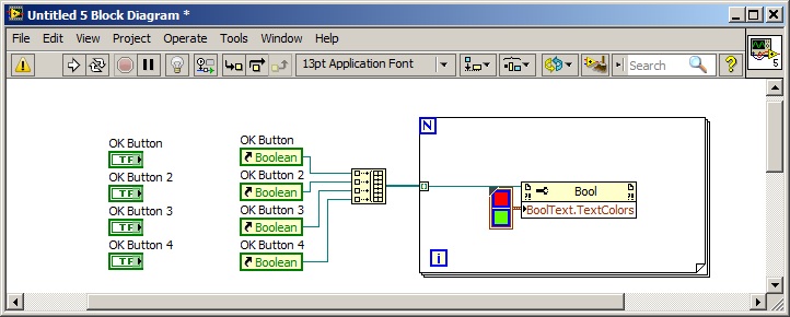

One way to do it is to have an array of references to all of the controls that you want to change and
use a for loop to set them in one go. You can add as many properties to the property node as you wish.

Another neat way is to select all controls on the panel and then use the reference typecast to 'filter' the boolean controls for you. Smiley Happy
Non booleans controls cause an error case and so no attempt is made to change their boolean text colour.
Message 4 of 21

Or for multiple controls, following on from Gerds advice ...
Like this Smiley Happy  Although if you have 100s of controls, adding them to the event structure won't be much fun !

Hi Neil (both of you),
getting the references for 100+ controls is fun (and easy) when you use the "controls[]" property of the VI front panel!
