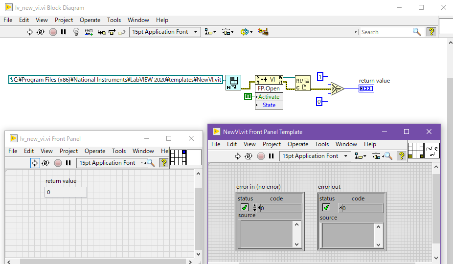

It worked!
1. Create a VI with a custom icon and error input/output and save it as ".vit" in the "LabVIEW\templates" folder.
2. Create "lv_new_vi.vi" in the "LabVIEW\resource\plugins" folder and place the functions(see image).
In this way, a VI with a custom icon and error input/output can now be opened as a new VI with Ctrl+N.
I was not sure how to open the "NewVI.vit" saved in the template folder from lv_new_vi.vi, so I referred to this post.
https://forums.ni.com/t5/LabVIEW/How-to-create-a-default-icon-and-replace-current-one/m-p/2566355#M7...
