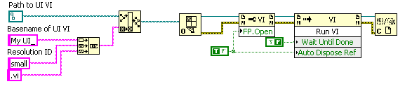

(2)  Nope, the launcher will not display it's panel (except you want to have a so-called "splash screen" during startup which would come handy here). The launcher would look like this:
The UI itself would work like a module calling a dll.....

Your approach differs in the way it works. My approach is a simple launcher which would retrieve the current resolution and therefore selecting the most fitting UI VI. This does not need any dialogs (except if desired) and the launcher will start up the VI and then finish working. This is what we define as "Launcher".
I'd call your approach a "controller" because your controller launches the UI VI, but wait on its termination. This is a little difference, but remarkable.
Yes Norbert, I understood this difference. I would say your approach is what is better in my situation. I would need the launcher, and not controller. Actually I was not sure about the usage of those two boolean inputs. So your sample helped me in that way.
BUT, again, this is not a single VI with two UIs literally. Even in your approach (actually our approaches are different only in the way the VIs are called and stopped, I see), there are two VIs apart from the launcher VI. The redundancy of code. No? If this is incorrect, I would appreciate, if you could just make a small application with the VIs that you're saying. If possible for you.
