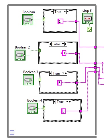

But how I can transmit boolean values via VISA write? On the input is string only.
Here it is, my inefficient solution:

You can use a U8 and the byte array to string and then send 4 bytes.

Or send a single byte. The first four bits could be the channel and the last four the state. OR them together.

What is 'U8'? Sending 4 bytes (0,1), will complicate situation - I can't recognise if it is channel 1 or 2 etc, because my Atmega will read only 1 byte and then another byte. It will be neccessary to use separator or something like that

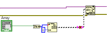

Ok, seems good. But how I can write information about channel and state to 1 byte array? Array of 8 booleans? Array of booleans will lead to string conversion error

A U8 is an integer - 8 bits.
I just realized that you don't even need to send the channel. You only need the state information with the last four bits. Channel 1 is either 0x01 for on, channel 2 is 0x02 for on, channel 3 is 0x04 for on. Channel 4 is 0x08 for on.

You're smart, thanks! But there is problem in conversion of array of bytes to string...

And of course value 0111 can't be converted to numeric
