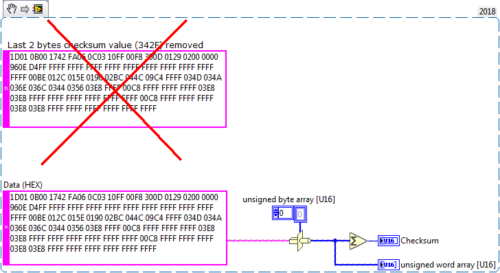

I have the below response back from a undocumented instrument's EEPROM through serial port when i send the string command @p
1D01 0B00 1742 FA06 0C03 10FF 00F8 300D 0129 0200 0000 960E D4FF FFFF FFFF FFFF FFFF FFFF FFFF FFFF FFFF FFFF FFFF 00BE 012C 015E 0190 02BC 044C 09C4 FFFF 034D 034A 036E 036C 0344 0356 03E8 FFFF 00C8 FFFF FFFF FFFF 03E8 03E8 FFFF FFFF FFFF FFFF FFFF FFFF 00C8 FFFF FFFF FFFF 03E8 03E8 FFFF FFFF FFFF FFFF FFFF FFFF 342F
Checksum = 342F ( last 2 bytes in the above response)
I have searched and tried few combinations from the posts on this forum. could not get the correct checksum calculation.
can some one help please.
Thanks in advance

This does not look right, because the strig is formatted in hex as plain string (printable characters 0..F and spaces). Shouldn't it be a binary string and look like that in hex display?
You are not removing the last two bytes but the last space and four bytes " 342F", i.e. 5 bytes.

Who made the instrument?  Who made the EEPROM?  Any manufacturer information may help lead to the standard being used.  Otherwise, it is a complete shot in the dark.  There are A LOT of ways to perform checksums (simple summation, standard CRC with who-knows what parameters such as polynomial, bit order, where the XOR is performed, invert the final value or not, etc).
Here it is. As altenbach said, the data needs to be in binary format.

Instead of using Type Cast, I recommend using the Unflatten From String simply because you can specify the Endianness (the byte order of the values).
