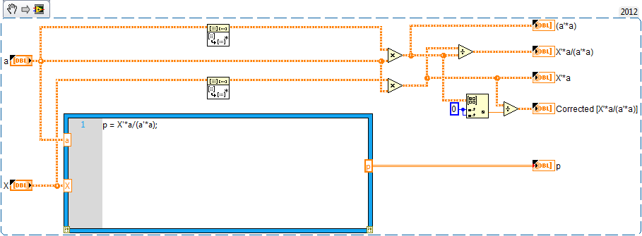

After several days, I was finally able to get the results of the two VIs to be similar, but not the same. I have not been able to find any explanation for this on the forums or elsewhere. The major thing that I found is that LabVIEW breaks a bit when you have a vector calculation such as a'*a which should result in a scalar value, or a 1x1 matrix. When you use this value in another equation, such as the projection X'*a/(a'*a), LabVIEW only operates on the first element of X'*a.
Here it is in GCode with the work around to correct for the a'*a result:
It seems unusual that GCode would treat a scalar result incorrectly. This was annoying, but I was able to get past this.
