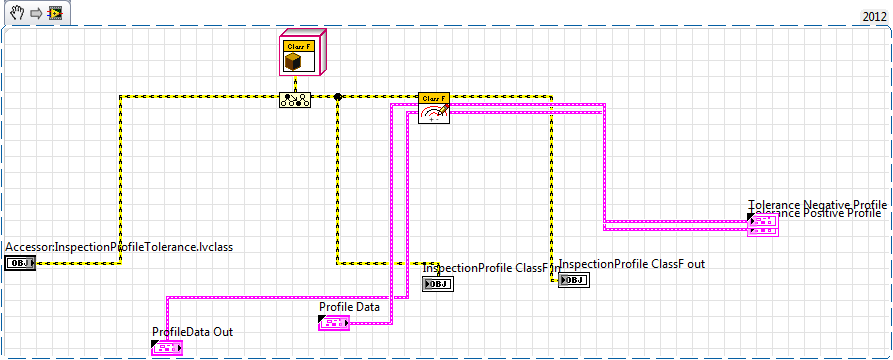

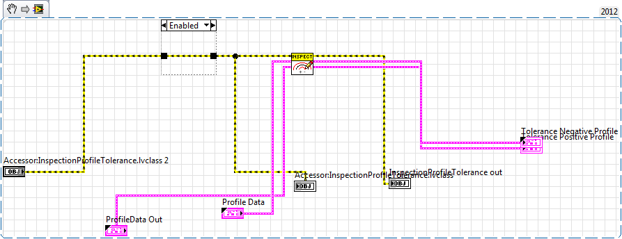

I have ben able to make it work by adding a "To more specific class", see picture below.  It is as if the dynamic dispatch not working.
 This one forces the use of the child class
This one is as it should be...

When I use a : "To more specific class", using a new instance of my child class it works in the exe.  But that way, I loose all the magic of having LOOP, no more dynamic dispatch.
