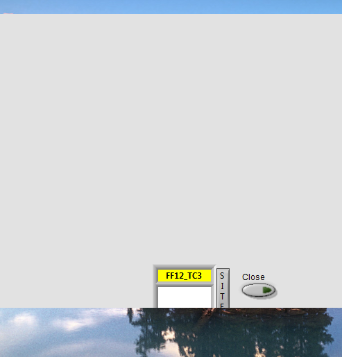

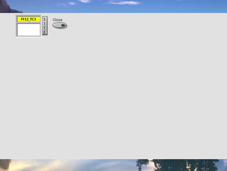

Hello All,
I would like to do call control on demand, the approach i use is async call the sub vi and set it as child window
however when i scrolling down the main vi, the child vi seem stuck on the top border
but it has no problem in bottom or side border
bottom borderbottom border

Hello CARYA,
i already manage to set the sub vi as the child window of main vi
the problem is, when i scroll up (while also doing repositioning in background), the child window behave abnormally when it touch top border
but it behave normally(just like normal control) in bottom border

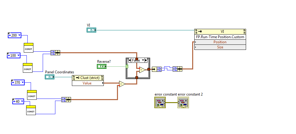

Hello Carya,
if this vi is disable, the sub vi will stay at the same position regardless how i scroll
Message 9 of 26
(3,889 Views)
I'm surprised the FP.Run-Time Position.Custom method does anything when the VI is inside a subpanel. You should not use it in this case.
I'm pretty sure the sub VI is not in a subpanel control, or that you are controlling the subpanels position in another peace of code.
If you insist on using the concept of a subVI as a "child window", you're setting yourself up for failure. LV has subpanels for that.
If you want to control the position of the subpanel (and the VI in it!), use the subpanel's position property. Thread the subpanel as a control. Don't think about the VI that's in it. It's a control, and you can set it's position like any other control. In fact, to get you started, try to set a Boolean control's position until it's as desired, then link the property node to the subpanel.
If you want to control the VI's origin inside the subpanel: get a reference to it's FP, get all panes, and set the origin of the first pane.
