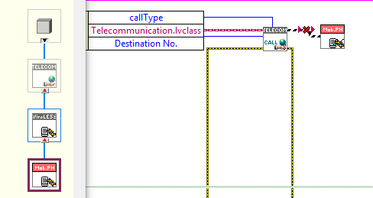

I think you're going to have to attach some code to help us out. The picture you are showing has a broken run arrow so it won't throw error 1448 because it can't even run.
My guess is that you have instantiated a telecom class object and then tried to cast that to a mobile phone class.

Sorry for the mistake..
Let me explain the situation:
The Telecom is the root class as you can see in the hierarchy, am not giving the instantiate telecom's object here but, the each class object is connected at the other end of event structure: as device handling which predicts the input class object at that instant when user selects that control.
I'm think I need to find a procedure to publish Mobile class.Obj to be visible on the front panel of my application only through static read_Accessors. And note that, there are/should be no indicators inside my dynamic methods (MobilePh_has only dynamic dispatches).
I have attached the project for reference and please point out if there are any other corrections so that I could make my learning proper.
Note: This error persists only when device handled is not Mobile phone.

And that is the way it should work. You can't cast a class object to a sibling class, you can only cast a cast to the correct type of the object or to its parents.
So a Telefone object, running on the telecom wire, can't be cast to a mobile.
The error you get is correct. If you put a Telefon, Telegraf or  Walkie Talkie object on the wire you will get that error, as they are on a mobile class type, or any of the mobile class parent type.
The important part is what class object is acutal running on the wire, not the wire class type.
