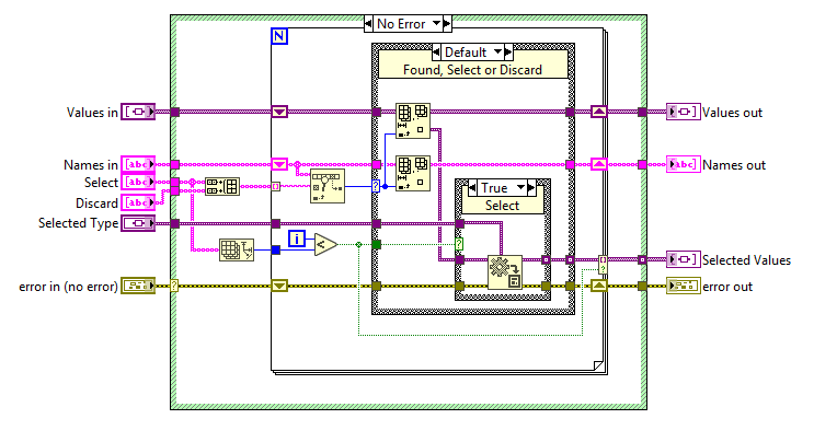

My situation:
  • I have some library containing a couple of classes, one of which contains a public-scope malleable VI.
  • The VIM doesn't access class data
  • In LabVIEW 2017, this compiled to a PPL fine
  • In LabVIEW 2019, I'm given an error message with the text "You did not specify a top-level project library or the top-level library you specified contains an unsupported malleable VI."
  • Moving the VIM out of the library allows compilation (because really it doesn't contain any class-specific code, so it needn't be a class member or even a library member)
Is this expected behaviour? The workaround in this case is simple, but I'm unsure why it previously worked and now fails. I'm glad the error message was at least suggestive of the problem though.
The malleable VI and a screenshot of an example caller are attached.

I can post an example later when I have a computer available but I think I've worked out at least why it can't be done now. Perhaps previously it was excluded but didn't trigger the error.
When the VIM is part of the library (I think the class is irrelevant in this case, but I haven't checked that), and has public access scope, LabVIEW should try to make it available to callers of the compiled PPL. However, I'd guess that actually this doesn't make much sense - what is a compiled inline VI without its caller?
Once I move the malleable VI out of the library, it no longer forms part of the API and so can be cleanly compiled into the library (class) VI(s) without concern that it might be needed with different datatype.
