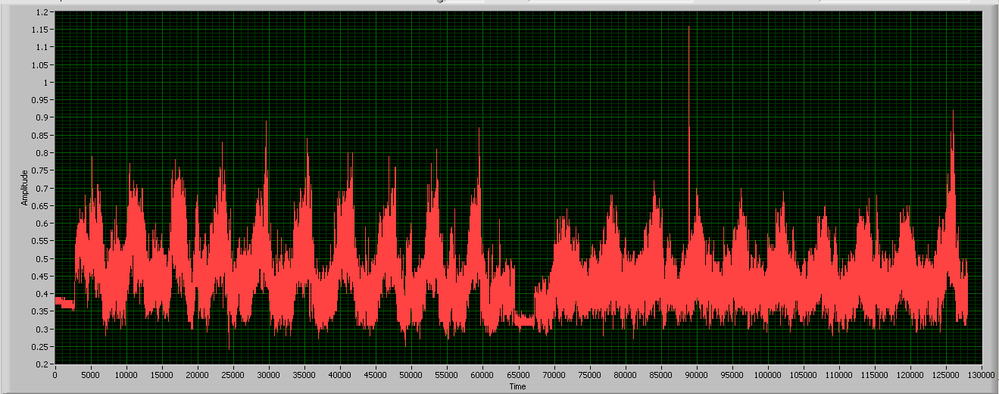

Hello there, i need some insigh on this project im coding.
In the atached files there is a .dat file, wich contains an array of 128000+/- numbers,

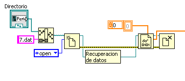

here are 2 images, one of the array on a graph (data)
and a code i use to extract the data from the file.(codigo)
Any ideas on how can i eliminate those big spikes?, i want to stay with the noisy signal just want to cancel any peaks, also this has to be dinamic, because this is data from a sensor, but other sensors have diferent offset or diferent amplitude, this is a bearing check and those peaks are imperfections, i want to eliminate them, then using an envelope detector (i have that, Hilbert-ish code), give the envelope some offset and then compare so i can see if the peak is within boundaries.

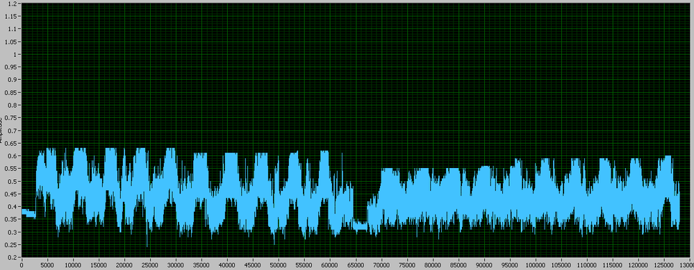

You could simply use the Y[i]=Clip{X[i]} function in the Signal Processing > Signal Operation palette.
With a value of 0.75 you get something like the 2nd waveform.
Cheers
Neil

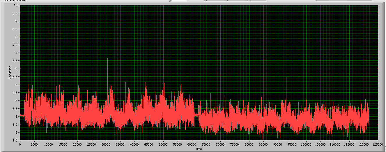

Thank you for your answer, the thing is, Signal varies in amplitude, so in some parts I could have something like this:
as you can see, the offset is around 3, if I clip it on 0.75 i would loose all the signal, im in need of somethin dinamic and not static as clip.

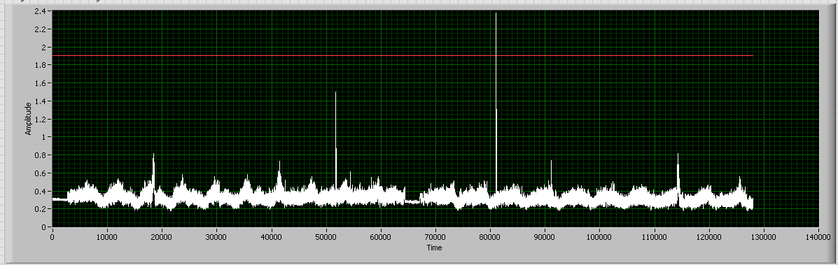

Thank you, it was ok but i need something more dynamic, because i have pieces like the one below, using you code snippet, it doesnt behave the way it should,
also keep in mind that some pieces are clean and with this method maybe clean waveforms will loose data, i've attached the above data.

Hi yoko,
Using the same code, made it a little bit more dynamic, now it will adjust the trimming index and decrease it a little more until it detects 3 (or whatever value entered in control) trimmed peaks, this means that the triming level will vary for every waveform. I checked with the 3 groups of data you posted and it looks pretty well. If you want it to be more severe, you can increase the number of trimmed points, with the risk of deleting some waveform data. As you can see, there´s plenty of modifications we can do on the code, so I recommend you to play with the similar fucntions if another specification should appear.
Hope this helps, cheers!
