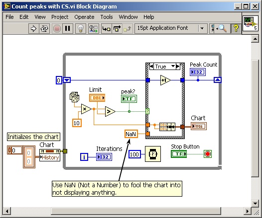

If all you are trying to do is clear the chart, then you just need to write an empty array to the History property for the chart.
(5,661 Views)
I can't see your block diagram because it is password locked.  But you only need to create a history property node, make sure it is set to write mode, right click on the input and click Create->Constant.
aputman
(5,659 Views)
Here's a pic of what was mentioned previously.  Note that it is a good idea to wire the error out to force it to execute before anything else.  Also note that I have two plots in my chart so when I created the constant it made a two element constant.  If you change the number of plots in the future your property node will update but the constant will not so it will beak the wire and you'll have to update the constant manually.Clear Chart.jpg
