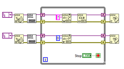

Hey everyone, I am doing the communication between two com ports on host PC and i want to clear the write buffer every time i send the data to receiving port, and want to clear the receiving buffer (old data) every time the new data arrive, here my VI

This attached snap will help you, where you are struggling. Don't close the port at every time!
I suggesting, could you clean up the block diagram. It seems dirty one.
