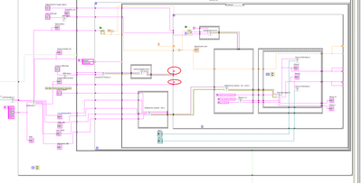

Your problem is related to "Uninitialized Shift Registers" - you can read more about shift registers here: Shift Register.
In particular, (image below) I've circled the uninitialized SRs that are storing the memory of the previous "Marker" values.
You want to probably connect these to SRs on the outer For loop, and then reset them for each run (you said you have 2 For loops, but there are actually 3 - you want the SRs to be wired in the inner two, and have an empty string wired to the initialization of the middle For loops SRs (the outer For loop won't have SRs for the Marker values)).

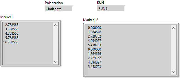

Thank you for your ideas. Not sure that I am getting it right.
Please see the attachments, I just put 3 loops together and simplified the 3 loops to simulate a bit what is needed.
When running this, after each run I should be getting what is shown in this word file.

Hi agyna,
A few points:
  • Generally, saving code to an older version will help more people on the forums help you - see Saving for a Previous Version.
  • I realise this is simplified, but take care to avoid duplication if you can - your Local Variable for Polarization could be avoided by moving the indicator outside of the Case Structure.
  • You need to add an End-Of-Line character somewhere, consider if you want "\r", "\n" or "\r\n" (these have constants in LabVIEW, or you can switch the display mode of string constants and type them with the "\" character.
  • Although I suggested moving the initialization of the Shift Registers, you replaced them with Feedback Nodes. This is still fine, but you still need to initialize them further out. Right click on them and choose "Move Initializer One Loop Out". Move your Empty String Constant out to the place where you want to reset the string indicators. You should get something like this:
Note that you'll still need to do the same for the other case too - it may be easier (depending on exactly what you want) to use the Shift Registers instead, but you have to wire them through the loops (as shown in the lower case).
