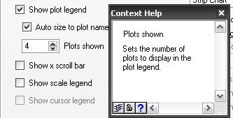

I cannot figure out how to clear the unused lines from some of my Waveform Charts. At one point I had 8 plots running, then I changed to only 4. In the properties screen, I see that show 4 lines is checked but I still get 4 undesired lines at 0 in addition to my desired 4 lines. The Plots tab in the Chart Properties box shows options for 8 plots and I can't find a way to clear them. I have a blank array wired to the History input property.

Hi BassBuilder,
Are you referring to the "Plots shown" property on the Appearance tab? If so, that property refers to the number of plots to be shown in the Plot Legend, not on the chart itself.
The number of plots on the chart itself is determined by the number of inputs. Please let me know if you have further questions.
