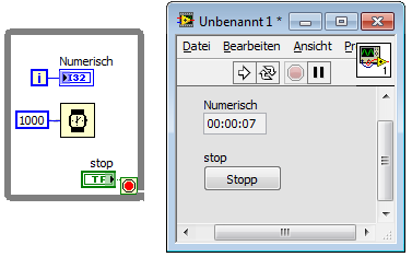

and I think all you need is this:
You can set the formatting of numeric indicators to a lot of different formats…
