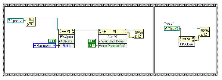

Hi!
Did you set AutodisposeReference to True?
Look at this BD I'm currently using:
