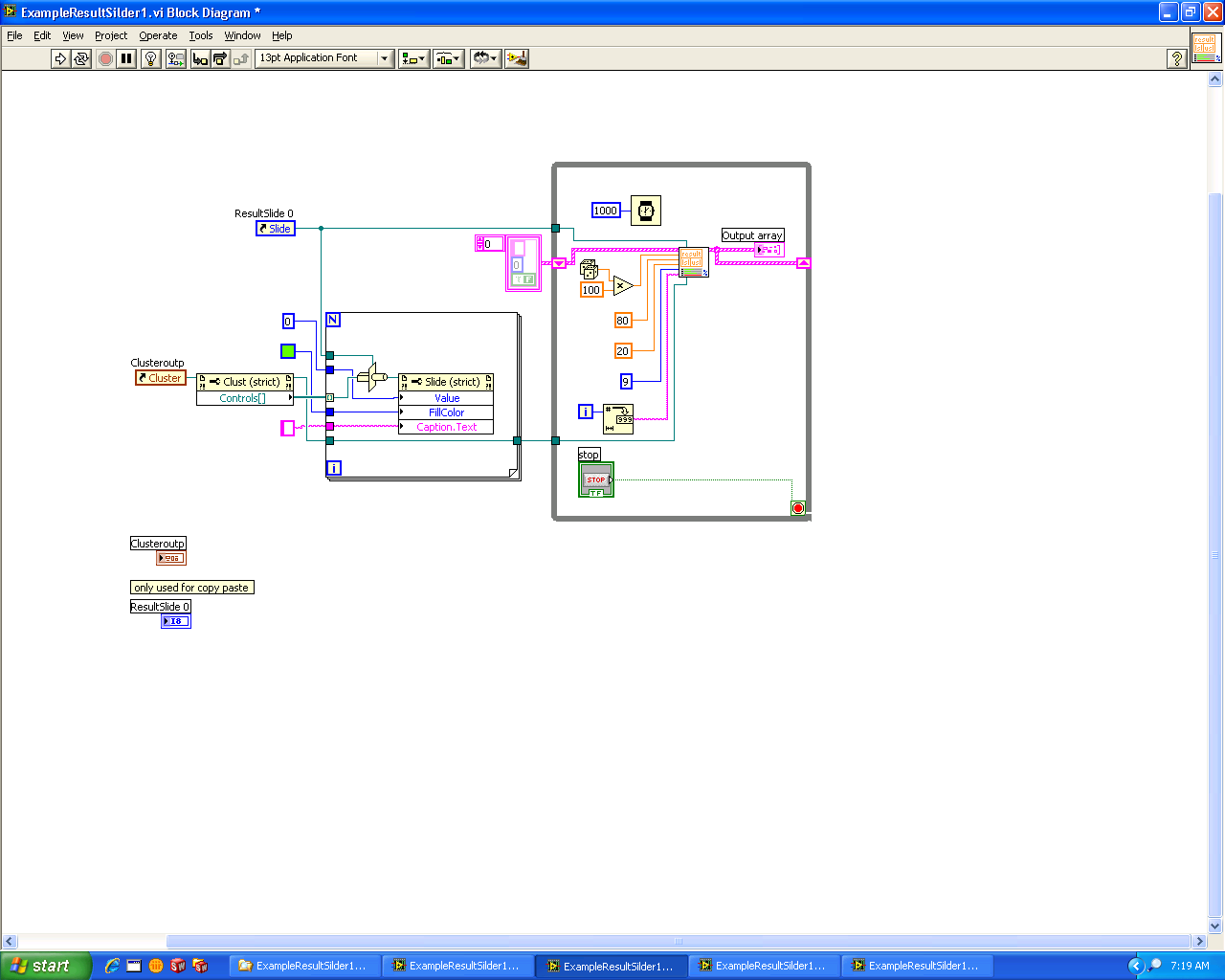

Cluster of slides not filled the colors
Hello jack47,
I'm using already a progress indicator as sub.vi with ref num and properties and that works fine.
But now i use a cluster of sildes and that does not work.
i did try to use an example from National Instr (with strings) and modified it with sildes but again it does not work.
If it is so easy then please can you send me an example that works or a diagram in pdf format?
Kinds regards, Ben Arts

What version LV are you running.  I can modify your example vi and post it.
Message 12 of 16
(860 Views)
Hello jack47,
we have version 8.2.
I'll wait for you modification.
Thank you.
Kind regards, Ben Arts
Message 13 of 16
(841 Views)
I posted pictures of the block diagrams after I got a strange warning about saving the vi's to 8.2.  Hope they still work.
Message 14 of 16
(836 Views)

Hello jack47,
Thank you for your modification. I'll try it to look if it works.
I see that there is more code(controls and properties) needed in the testresultsilder.vi.
That is what i try to avoid, but maybee this is the only way that it works.
I use it as an indicator to show the test results.
Another way to show test results is a waveform graph. I will look both methodes.
See my example.
Kind regards Ben Arts
