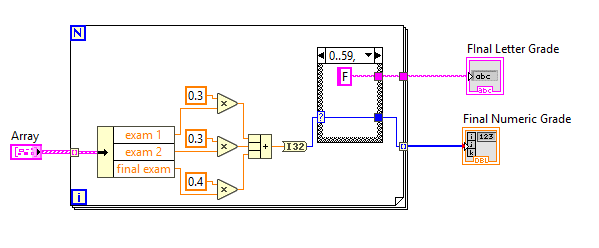

Here is a start. You calculate the results for all of the tests and if the tests fall into a certain range, you can denote the grade (F for 0-50 etc)

The input here is not a cluster of arrays and i can't enter info for multiple students. So i can't rank them either. How would i solve this issue.
Thanks for the help 🙂
