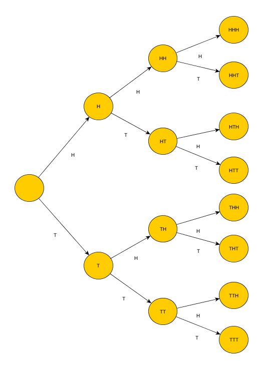

@RavensFan wrote:

Ok, lets take a close look in that tree graph. It is a toin coss tree with three tosses, each chance (H:T) shall be 50:50. So what is the chance to get HHH?
The algorithm is 0.5^3 = 12.5%. But let's count it out. HHH is only one time present in the last toss-column (top circle). Overall, the tree has 8 circles in the last column, so the chance of HHH could also be stated as "one success out of eight possible results". 1/8 = 12.5%.
Fine, let's look into the next task: What is the chance of getting at least two heads in a row in three tosses? Our pattern we look for is "HH" in three letters. Let's count: Three circles in the last column contain the string "HH":
HHH
HHT
THH
So we have three successes out of eight possible results. This makes up for 3/8 = 37.5%
If we'd ask "what is the chance of getting exactly two heads in a row in three tosses?" instead, the chance would be less. Only two circles cover that requirement:
HHT
THH
The chance would be 2/8 for this = 25%.

You do have the question initially:
"What is the chance of getting at least 10 heads in a row out of 1024 tosses?"
As we can see in my examples above, at least increases chance if the number of tosses is (much) greater than the number of expected "successes". In a row on the other hand greatly decreases the chance. The bad thing is that they do not compensate one another. "In a row" creates dependencies in the results (not affecting the individual toss chance!).
Hope this helps shedding light on the discussion,

Hm, i did forget to state the initial hook up for my examples above.... 😞
The situation you were confused about with my statement regarding 10 heads in 11 tosses is the "at least" vs. "exactly" confusion. Looking in the tree again, we will now ask two new questions:
What is the chance of getting HH in two tosses?
Answer: 1/4 = 25%
What is the chance of getting exactly two heads in a row in three tosses?
Answer is already in previous post: 2/8 = 25%
So adding a toss does not change the chance if you require exactly the number of successes.
If you change the requirement to "at least", everyone else is right that adding a new toss increases the chance.

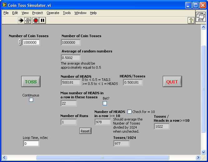

Yes, that's all very interesting, and proves the obvious that how the question is worded changes the results! Smiley Happy
Anyway, when I run my vi, attached, say 1 run of 1 million tosses, this is my results (results are similar every time):
Notice that I'm getting my expected results. I get >= 10 heads in a row on average about every 1024 times, as I originally postulated. This agrees with the results I get when I run Don_Phillips' "New HTs.vi". It does check for 10 heads in a row, but runs continuously, so this is also what I'm looking for. Smiley Very Happy
I'm not getting 2048 as crossrulz's vi shows.
(That 40% number was a red herring; it indicated something else as was pointed out!)
(I know my vi is not coded very efficiently, but it works.)
Ed

I think I found a bug in your code.  For your Head>=10 variable, it increments whenever the current streak is >=10.  This means it increments when the streak is at 10, 11, 12, 13, etc.  So for a single streak of 19, it increments 10 times.
Message 88 of 92
Yes, that's how I intended it to work. That looks like the difference with your code, and why mine works like Don's.
