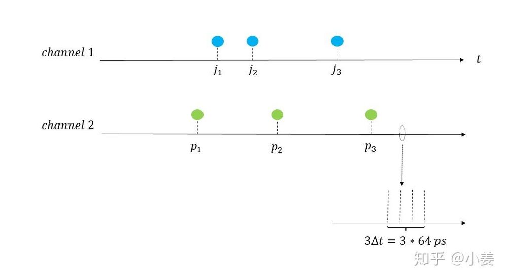

I think you want to calculate the time interval between any photon pair from two APDs?
