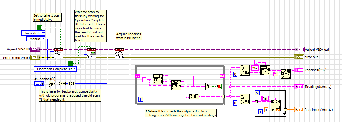

The 34980 is a lot like the 34970 I use. Here is what a configure for a 34970 looks like.

The 34970 VI's are from here http://sine.ni.com/apps/utf8/niid_web_display.download_page?p_id_guid=014F4CD7EF78136AE0440003BA7CCD...
This is only the initialise state. Using a 34970 properly is a two step process
  1. Configure all channels and a scan list
  2. Scan the 34970 to get the readings
So the case I am showing only runs once a the start of my program and I scan at regular intervals
I did make my own "Scan" vi that has several output options, it is a modified version of teh 34970 scan example.
