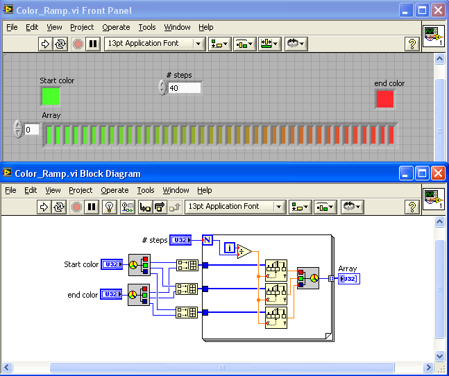

It just sounds like you have to multiply "255" by your precentage (expressed as a fraction) and then combine the components.
This image show how to apply the same percentage to all three components of a "starting color" to produce a color ramp.
If that does not solve your challenge, post some code and we'll take a closer look.
