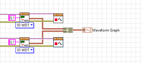

It was easier than I thought...

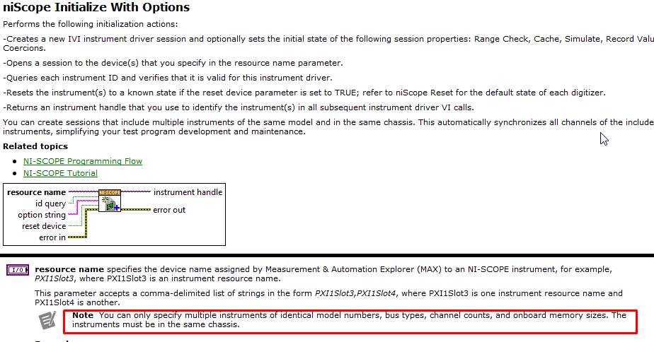

If it were a PXI Scope, you could use the channel expansion feature of the Scope driver to let the driver layer manage the merging using triggers and you need to handle only one session as if it were a larger scope.
