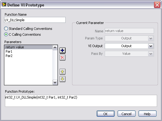

Quite easy.
Let's say - you have VI like this:
Now you should build VI into DLL. Then in build options prototype looks like this:
