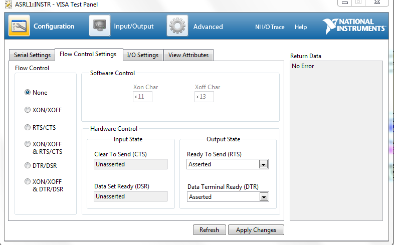

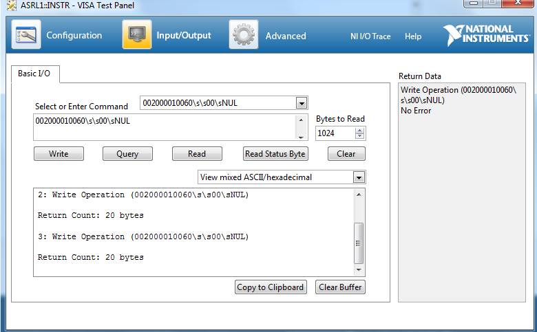

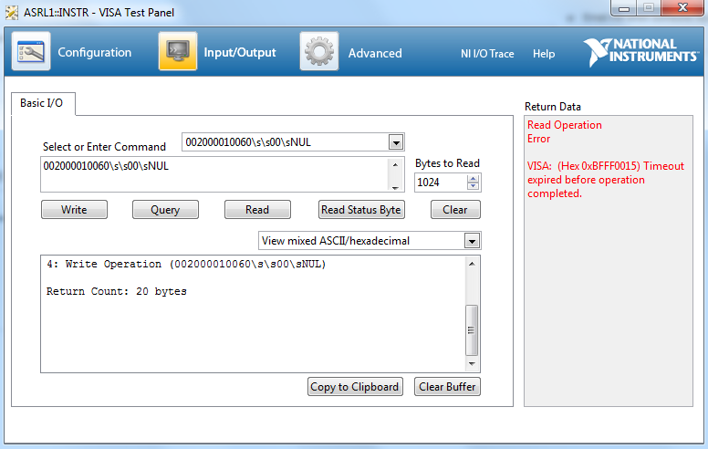

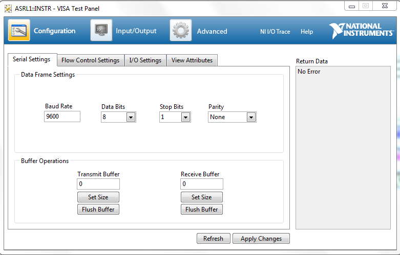

i am trying to send a MID 0001 command to my Atlas Copco PF 4000 via the Open Visa Test Panel or the Simple Serial VI. the command i am sending is 002000010060  00 NUL
but i am unable to get a response.
when i write there is no error when  query there is an error.
Besides this i also tried using a VI
and i have no idea.
could you guys please kindly help me thanks.

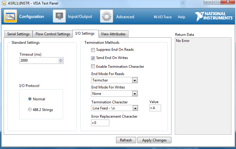

It appears you are supposed to be sending binary/hex/raw data bytes, but you are sending ASCII characters.  So with your VI, you should wire up a FALSE to the Enable Termination Character on the VISA Configure Serial Port.  Then you should right-click on your Write Buffer control and select Visible Items->Display Style.  You will see a little "n" show up on your control.  Click it and now select Hex Display.  The control will now show the raw data bytes in a hexadecimal format.  You can now type in your command, using 00 for the NUL character.
To give any more advice, I really need a protocol definition.
