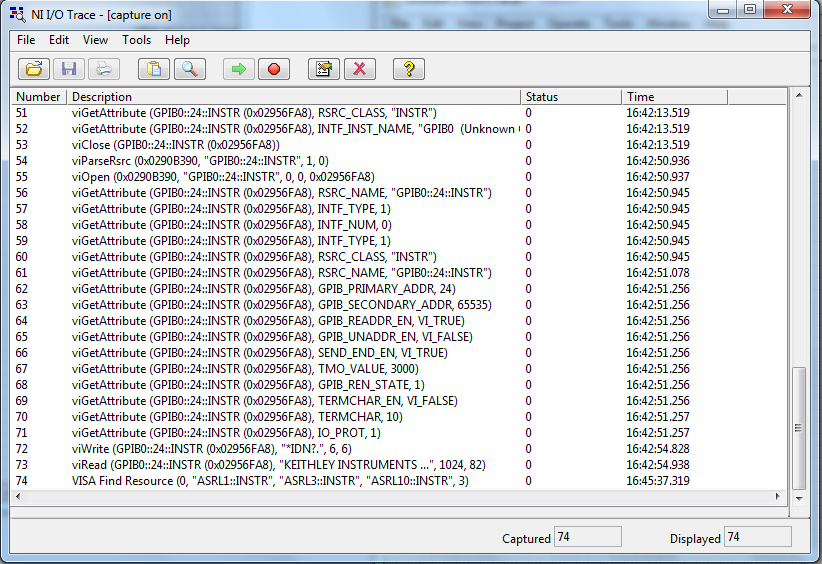

error5.pngHere is NI IO captured images.
 If you see the lines up to 73, it shows these computer and instrument communicate very well (address is GPIB0::24::INSTR).
But the line 74 (I run "find VISA resources") shows LabVIEW2017 can't read and send external instruments.
