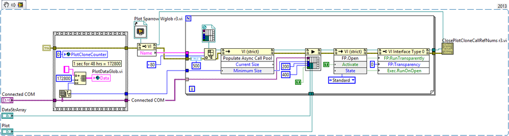

Opening clones with main vi...
The clone code...

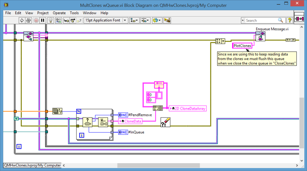

I'm using a GFV as a clone counter for the columns and the iteration terminal for the rows.  I would rather not predimension for a huge number of rows but rather add rows as necessary.  I've tried this with digital references and global variables but there is a problem as the first clone has new data before the last clone gets data.  Felt it best to open them at 500 ms intervals...

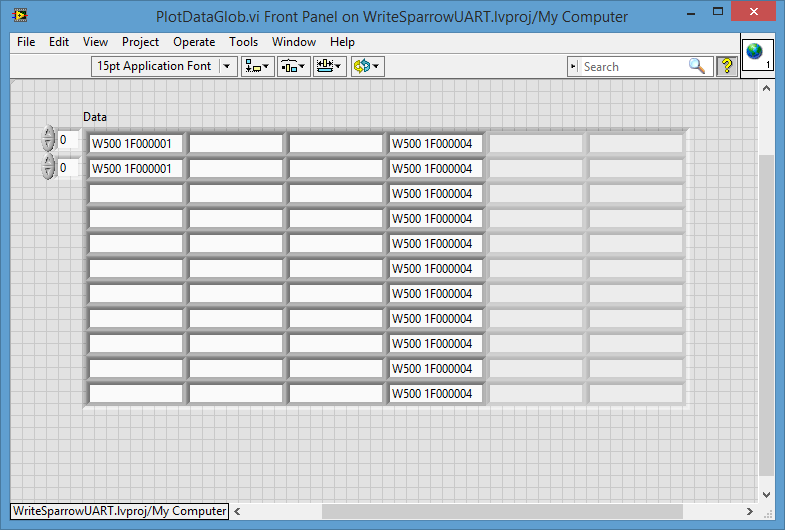

What I get using a global is...
Everything should be populated but it is not.  With digital references the results were worse.
Is there any way to succinctly collate in the main vi the results of a non-predetermined number of clones?

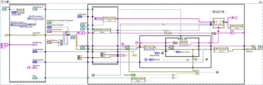

  1. Firstly, I agree with Kevin_Price - your code sounds like it would benefit a lot from trying to avoid things like Global Variables.
  2. Is using LabVIEW 2019 an option? The Map datatype would help a lot in simplifying some of this code.
  3. In your clone code, you have (based on the caller code's typedef) a lot of unwired (to the connector pane) controls. If these aren't changing (Serial settings, End Read on term, Term char, etc) you should make them constants to clarify the clone BD.
  4. You also have a lot of references - where are these set. I don't see them on the caller Async panel either.
  5. You're building a string from your VISA read using a While loop and bytes at port, but it looks like you have a valid termination character. If there isn't some reason to avoid it, you should use the term char to make a single read. Even if you can't do that for some reason, you might want to avoid repeatedly updating the same reference to a string (Str Refnum) during the read. Write it once afterwards. This ties in with Kevin's comments about optimizing your clone. I also don't see the refnum on the caller Async node - how is it populated? (You have DataStrArray 2, which I'm guessing is the refnum called DataStrArray on the caller, but no string refnums).
  6. Rather than using the global PlotCloneCounter, pass a value from the caller. You could wire this to "i" in the For loop.
  7. You're using a "wait ms.vi" from SparrowBTLEtest. If you're able to use LabVIEW 2017, I think "Stall Data Flow.vim" does the same thing, and is built-in. Not a major issue, since you obviously already have a workaround
I'll look some more and try do a bit of refactoring, but information about the input controls is fairly important (refs particularly). Any information you can add will probably help.
Edit: I'm suspicious that some of these references should be block diagram constants to existing controls/indicators on the clone, and that the snippet creation process maybe broke them. Is that true?

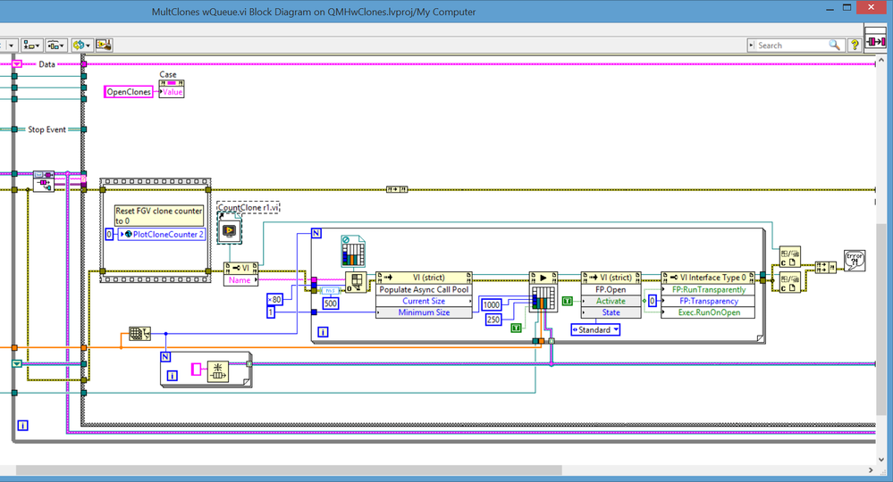

Thank you Kevin and CButcher.  LabVIEW 2019 is not an option at present though I wish it were.  To make a queued message handler work for an indeterminate number of clones I had to generate the queues in a for loop.

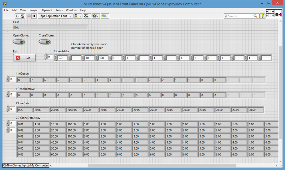

Made some EZ dummy clones to test...
Reading clones here.
Um, the snippet maker in my LabVIEW 2013 SP1 (full) does not seem to make representative pictures.  It adds strange references.
Not sure I need to incorporate user events into the clones as a digital reference seems to handle the stop well so I'm using a simple array of queues.  If it is difficult to send the Zero and Calibrate commands to the serial devices with digital references I'll set up user events with the control cluster.  However, I'm not sure of how to do this with the clones.
Since the clones open at 500 ms intervals and are then read at 1 s intervals, if there is a large number of clones the # in queue for the first ones opened is larger than the later ones.  Can open the clones faster...

Your array of queues isn't a good way for your main app to *receive* info back from the clones.  You're trying to dequeue exactly 1 sample of data from each of the clones, implying that they're all pretty well in sync.  But they aren't.  You're going to run into neverending unpredictable troubles with that kind of approach, I'm pretty sure.
A *much better* approach is that all clones enqueue into 1 common queue that the main app dequeues from.  In this approach, the queue ref itself doesn't give you correspondence to a specific clone instance.  To know that correspondence, you'll need to include appropriate info in the data carried by the queue.
   All this stuff is what I was driving at in points #2-4 in msg #2 of the thread.  At first it may feel more complicated to use an approach that requires you to send a more complex datatype over the queue and then decode it.  This is offset by the advantage that you can actually build a reliable working app this way.
More work will be needed, but the important thing is to understand that these 200 clones are operating independently and they won't stay fully in sync with each other.  You *need* to devise use an architecture and data structures that handle *asynchronous* updates from these many clones.
Your array of queues approach essentially wants the main app to "pull" data from the clones on its own fixed and rigid schedule that doesn't match the way the clones are running.  The approach I'm suggesting lets the clones do the "pushing" of data at their own pace and the main app handles the info as it comes in, i.e., according to the way the clones are actually running.
A closer look at your screenshots makes it appear that you may have tried to use the QMH template in your main app loop.  I would recommend letting the clones push their data messages onto this queue with its string/variant pair.  It appears you already have the structure in place to receive arbitrary message/data pairs, so go ahead and use it.
When I do this kind of thing with a QMH, I tend to have a typedef'ed cluster of "state variable information" that passes into all my message cases.  Different cases can then read from it or update it as appropriate.  Among other things, it'd contain info you'd need to dispatch data received from a specific clone to the correct corresponding destination(s).
-Kevin P

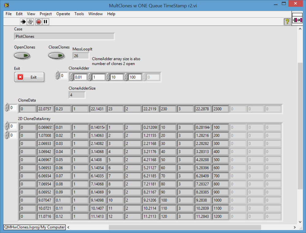

Kevin:  Okay, but parsing the data back is more difficult and perhaps not better than an array of queues as data may not be received in time from a lot of clones using 1 queue.
We have a personal toxic gas monitor to calibrate in production.  In UART mode the device outputs a string of device type (gas), SN, ADC, ppb, T, RH and P.  Best not to query more than 1 Hz as it might overheat.  When plugged in 1 at a time, no matter the COM port given by VISA, devices appear in COM array in order plugged in.  This is to help the operator figure which is which.  There are several commands to enter sensor bar-code, device serial # and the LPM91000 op-amp settings.  This is easy.
After sensor burn in at bias (24 hours or so) we wish to place in zero gas, read and plot the ppb calculated by nA/ppm in the sensor bar-code then when stable enter a zero command.  Zero takes about 45 seconds during which time the clones will not be queuing anything but the output string when finished.  Then we go to a concentration of gas, stabilize while plotting and issue a calibrate command.  That returns a string as well.  Finally, we return to the plot.  All sensors should be lined out at the cal gas ppb.  Those not within a certain tolerance the main VI can point out as recal or duds.  Then we go back to zero gas and check if returned to zero.

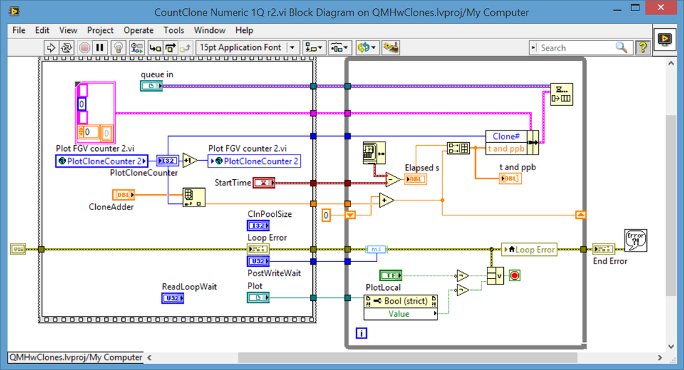

Here is what I've done per your suggestions.  Oh, we need an elapsed time to plot...

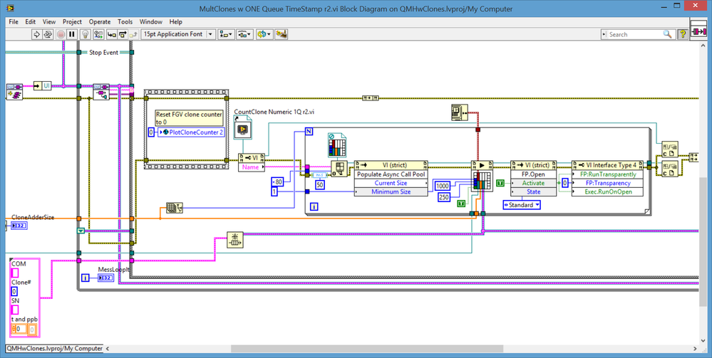

Open clones with 1 queue

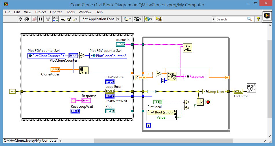

Clones, not using all the control inputs yet...

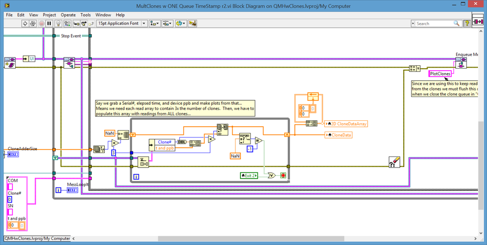

Making an array of the clone data to plot is tricky with 1 queue.  Below I have 3 columns for each clone, clone # from FGV (corresponds to order device plugged in), elapsed time and ppb.
Seems I must use an interior while loop to sort data replacing NaN in an array the size of which can change based on # of devices.
Front panel when running
This, once all clones are open, updates at the clone "read" rate.
In final v I could probably use SGL data type 2 b more concise.  Not sure I need to apply a user interface to the clones as just 1 digital reference with a type defined enum could do it.  Revised code posted.
