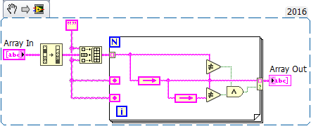

Accepted by topic author OJwithPulp
(5,226 Views)
The Search Array_ogtk.vi (from the OpenG Toolkit) returns an array of the indices that match the search element. If the returned indices array size is 1 then the element is unique. You can use this with conditional indexing output of a FOR loop. This can also be optimize for large array by sorting the input array and using the last index found as the start index of the Search Array_ogtk.vi for the next loop iteration.
