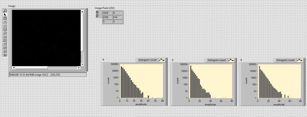

Hey Idriss,
you are suffering from the normal camera noise one would expect in such a situation (See Image Compare.vi):
If you want to compare the two images you have to account for this. Depending on your settings, the color channel you want to use you have to find the proper threshold. Personally i would start by simply calculating the standard deviation (append the negative array, to get the symmetric value) multiply this times 3 (99,9 something % of all points of the noise distribution reside within this window)  (See Image Compare.vi for this). I dont know if this is a valuable threshold for you, this is something you have to figure out on your own.
Anyway, your second issue regarding the performance. You are executing your code on a myrio, which is running the real-time code on a Cortex A9 chip. The decrease in performance is expected here. If you want to be faster you have to spend more money for a faster real-time system...
