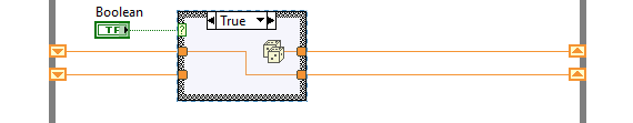

You need two new shift registers.
In the case structure, either wire both the shift registers through the case. Both values are retained when the button is not pressed. If the button is pressed, put the 1st (current) value in the 2nd (old) output\shift register. Wire the new number to the 1st output\shift register.
Alternatively, and less code but a bit harder, you can use a feedback node. The feedback node has an (optional) enable Boolean input. Normal shift registers are always enabled. So you can wire the Boolean to a feedback node enable, and the feedback node will keep both values.
Your "history" is not based on loop iterations, but on a Boolean state. That makes shift register less suitable, because they shift automatically based on loop iterations.
Never mind, those feedback nodes don't return more than 1 output. You can increase the delay, but it doesn't return all buffered values.

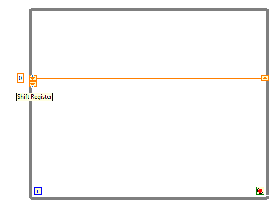

Actually you can just pull down the shift register to get the previous value:
Tim
GHSP
Message 6 of 12
(7,694 Views)
That just won't work.
EDIT:
That will always shift the current value to previous value, for each iteration.
Goal is to store the current value, and push it to previous depending on the press of a button.

I guess that depends on how you are using the shift register. The way you are developing your code. To say it wont work is inaccurate. It would depend on what you are doing with it. I just wanted to make the point that the previous value is available by pulling down the shift register. I did not say that it would work in this situation. It might if you did it correctly.
Tim
GHSP
Message 9 of 12
(7,664 Views)
Actually implies it's an improvement to what was previously mentioned as a solution. While in fact it doesn't solve the problem.
To say it won't work is pretty accurate.
How is this related to the way I develop code?
OP's requirements where clear. It was not to get the previous value, but to store previous value based on a button.
It is a valid point... But not really related to the question.
It doesn't. Perhaps you could show us how to use it correctly?
